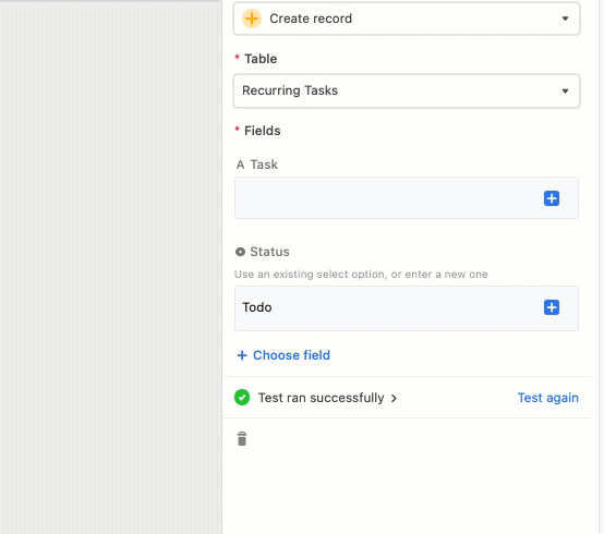

The next step is where things get fun—we can now setup an action to create recurring records. To create a new record we will make use of the " Create Record" action.

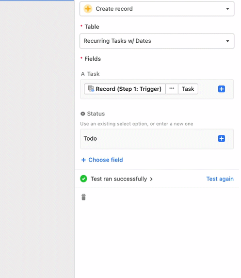

When our automation runs successfully, a record will be created in the specified table. The "Create record" action can be configured with multiple fields using dynamic values from previous steps, or static values. For this example, we will be using the "Create record" action to create records in our "Recurring Tasks" table.
Note that in the above step, we pulled in the dynamic "Task" field value from our previous step (the trigger step) and set the "Status" field value to a static value of "Todo". After adding the fields, you will want to test the automation to make sure no errors occur.

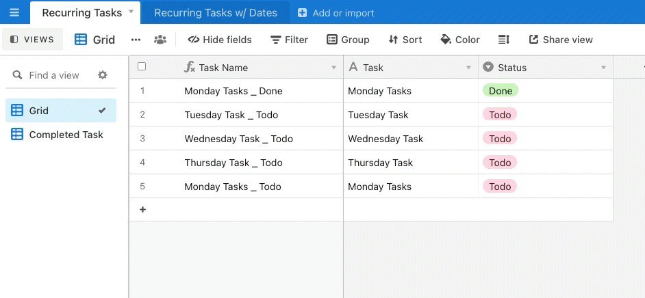

After our automation is turned on we can see that every time we change a task's status from "Todo" to "Done" a new task will be added to our table!

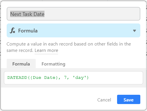

  2. With our due date clearly visible for each task, we can move on. To create recurring tasks based on dates, you will want to add a formula field to your table and use DATEADD([date], [#], 'units') to add additional days to the task date.

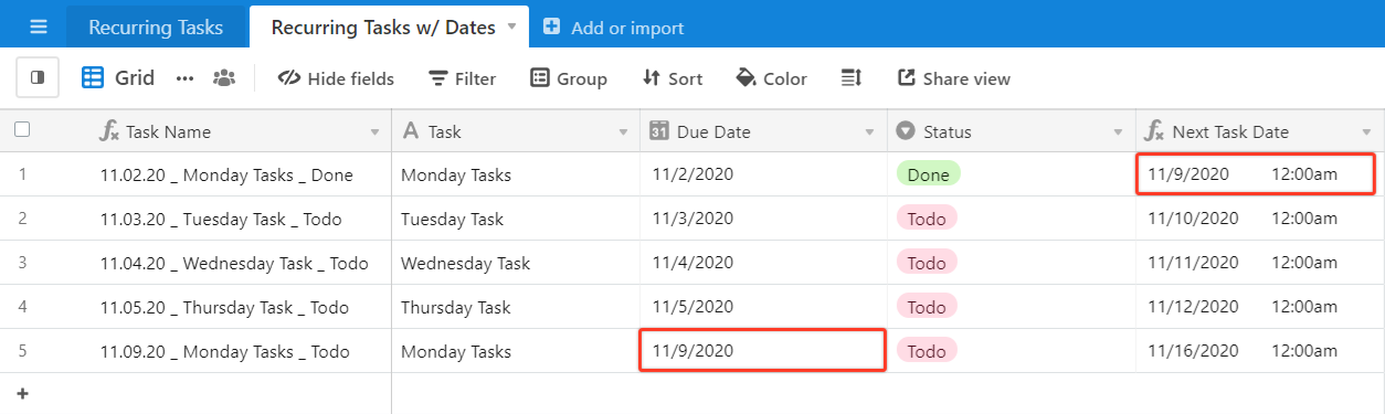

  3. For our example, we added 7 days to our task due date. Now, our primary field has all the information represented, and we are able to see that our "Monday Task" has the DATEADD formula calculating for the next Monday.

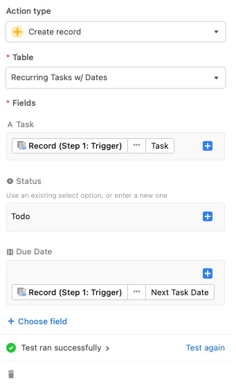

  4. Once you have a formula in place, you will need to create an automation. You can follow the same configuration steps above, however, you will be adding an additional field to the automation action. In our example, we named the date field "Due Date" and inserted the formula dates. By doing this, our automation will create a new record with the date set 7 days after the date of origin from the previous record.
  5. Once the "Due Date" field has the formula date value inserted, run a test to make sure the automation is working as expected. If the automation run is successful, you'll see a new record appear in the main grid view with the new date.
  6. Now you can turn on your automation knowing that every time you mark a task as "Done" a new task will be created using the "Next Task Date" set on the previous task.
