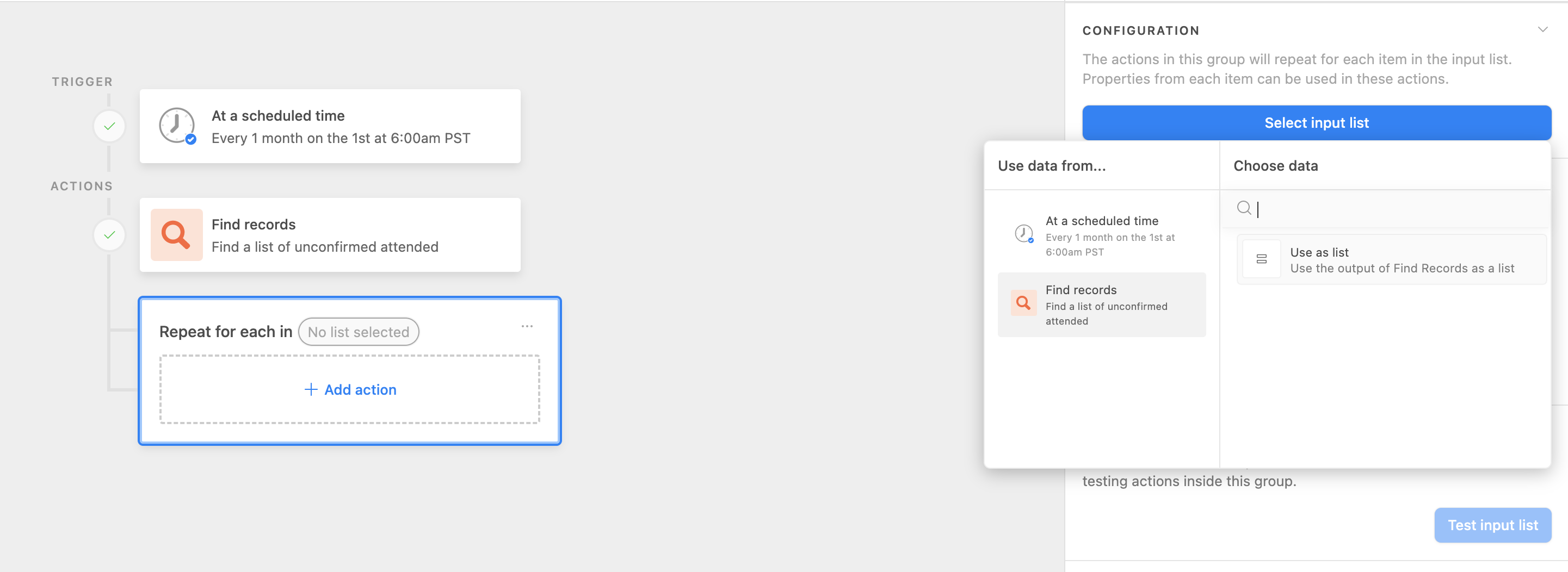

  5. The next part of the setup process can be broken down into four steps:

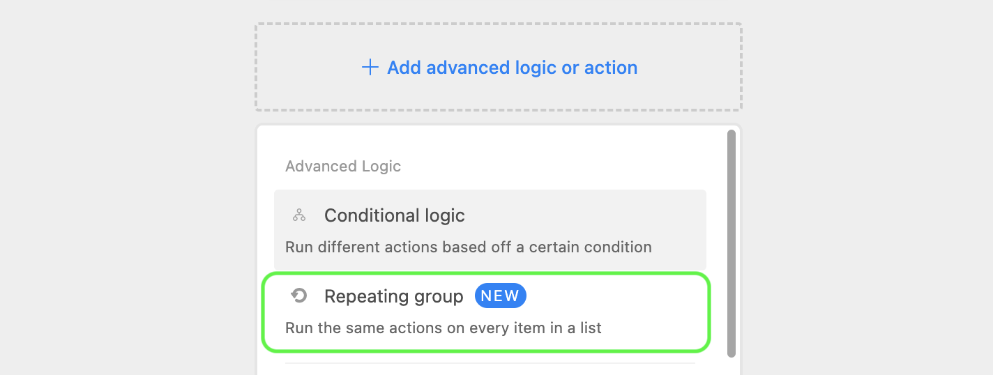

    1. Add a repeating group - Click + Add advanced logic or action and then click Repeating group to begin configuration.
    2. Select input list - After clicking Select input list, you'll first choose a source of data to use under the Use data from... section. The option you select here will be highly dependent on your workflow needs. In our example, we will be choosing the Find records action from the previous step. Next, under Choose data you'll choose which data will be used as a list. Again, these options may differ depending on the source of data that you are drawing from. In our example, we will click the Use as list option. Find other supported sources for input lists in the dependencies section below.
    3. Name and describe this repeating group - Under the LABELS section, you'll see the option to use a default name that Airtable generates or enter a Custom name yourself. You can also add a Description for the repeating group.
    4. Test - Finally, you'll want to click the Test input list button to make sure that the list looks as expected. Under the Results section you'll see an array (list) of items selected. The action(s) the automation performs next will perform their action(s) on each of the items in the list that is generated when the automation is triggered to run.

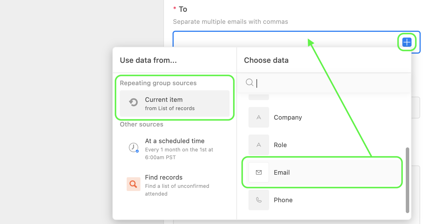

  6. Now that you've set the input list, it's time to set up one or more actions to perform for each item in that list. In our example, we will add a Send email action and use tokens from the previous step to dynamically input information that corresponds to each item in the list. For instance, we want one individualized email sent to each person found in the "Unconfirmed" view from the find records step. To ensure that the email is customized to each person:
    1. Click the blue plus sign in the To field of the email action's configuration window.
    2. Then, click the Current item option under the Repeating group sources section. Clicking this will cause options to appear under the Choose data section.
    3. In our case, we'll choose the Email token. The options here will appear differently depending on the name of the field in the underlying base.
    4. You can continue inserting customized tokens into the Subject, Message, and other fields that are part of the Send email action's configuration window. In our case, we'll also include a Name token in the Message that is sent.

  6. Click + Add advanced logic or action, then click Repeating group.
  7. Under “Select input list” :
    1. Choose the Find records action from the previous step under “Use data from...”
    2. Click Use as list under “Choose data”
    3. Add a custom name like "Update each found record" and optionally add a description.
    4. Click Test input list to verify the list contains the expected records.
