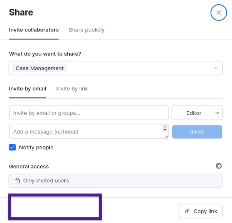

  5. A window opens, allowing you to share the interface in the following ways:
    1. Invite collaborators
      1. Under the “Collaborators with access” you can click the > icon to open a page that will allow you to see who has access to the interface. Here, you can manage access for interface-only collaborators. Note that this list will include workspace-level and base-level collaborators who cannot be managed via this screen.
      2. Under "General access" you can click the > icon to set a baseline level of access for a group of people in your organization, instead of inviting them one at a time. This is only available on Business and Enterprise Scale plans. See "Setting general access for an interface" below.
      3. Under “Invite via link” you can click the > icon to create a link that will grant interface-only access to users who click the link.
        1. To configure an interface sharing link, begin by clicking + Create new link.
        2. You’ll then choose which interface to share if there are multiple published interfaces.
        3. Next, choose what permission level the link will grant when accessed (Editor, Commenter, or Read-only).
        4. Under the “Access” section, you can opt to either "Only allow access to individual interface sections” or to “Allow access to base and all interface sections.” Note that allowing access to the base and all interface sections can impact billing and will grant access to the underlying base and ALL of the information held in that base.
        5. Under the “Who can access” section, you can either “Allow any email address” or gate access to an individual email domain by entering an email domain next to “Only allow emails from.”
        6. Once you have configured the link to your needs, click Create invite link.
        7. This will take you back to the previous menu where you can click Copy link to share the invite link.

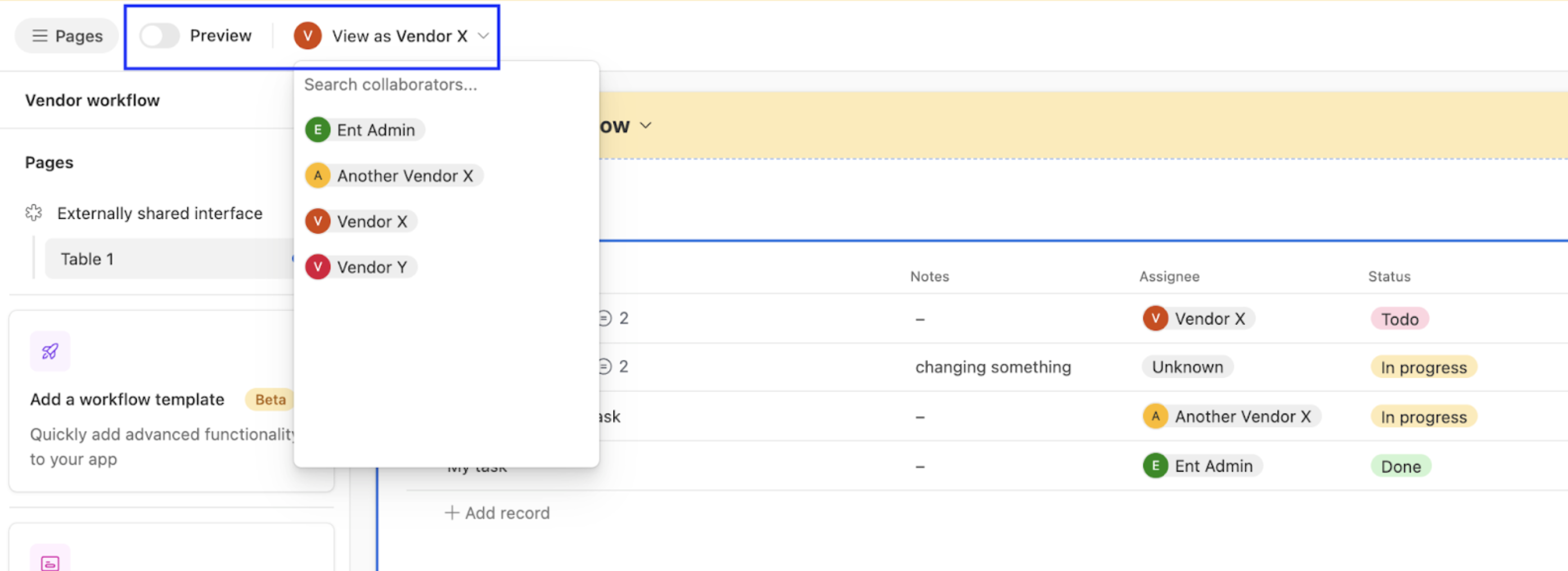

Checking a current user filter before you share the page
The "Previewing as" control in the upper left of the interface editor shows you the page as another person sees it. It's the quickest way to confirm that a current user filter returns the records you expect before you share the page.
The picker only lists people who already have access to this interface, and you can't type in an email address to add someone to it. Anyone you haven't shared the interface with yet won't appear, so a filter written for them can't be simulated. You'll keep seeing your own records, which looks the same as a filter that isn't working.
When the people you're building the page for don't have access yet:
  1. Preview as a colleague who does. Add that person's Airtable account email address to the records the filter reads, preview as them, and confirm that the expected records appear.
  2. Check the empty case. Preview as someone whose email address isn't on any record, and confirm that the page shows no records. This tells you the filter is being applied rather than ignored.
  3. Remove the test values afterwards, then check again once your intended viewers have access. The comparison uses the verified email address each person signs in with, so an address that differs from the one on the record returns no records.

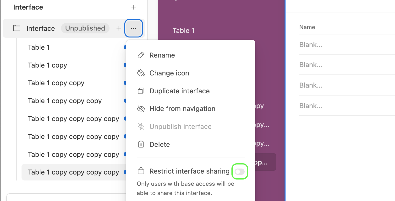

Unpublishing Airtable interfaces
To unpublish an interface:
  2. Open the base hosting the interface you want to unpublish.
  3. Click Interfaces at the top of your base.
  4. Click the … icon next to the interface’s name on the left side.
    1. You may need to click the three horizontal bars icon to open the sidebar.
  5. Click Unpublish.
  6. Click Confirm.
Hiding an interface page compared to unpublishing it
Hiding a page and taking a page out of circulation are 2 different actions, and it's worth knowing which one you need before you rely on either.
To hide a page from the navigation menu:
  1. Open the interface and click Edit.
  2. Click the three horizontal line icon in the upper-left corner of the screen if the left sidebar isn't already open.
  3. Hover over the page you want to hide.
  4. Click the eye icon.
To continue drafting a page and ensuring that any changes you've been working on won't publish until you are ready:
  3. Hover over the page, then click the … icon.
  4. Toggle "Keep as draft" on.
  5. Optionally, click Publish to allow other pages you may have been working on that aren't kept in a draft state to be updated for end users to interact with.
  • Hiding a page removes it from the end user's navigation menu only.
  • A page marked as a draft stays out of circulation until you toggle "Keep as draft" off and republish, which also means end users don't see edits to that page unless it eventually is republished.
  • To restrict who can reach an interface at all, rather than which pages they see, use the interface's access settings described in the "Managing interface access" section of this article.

Organizing a base with many interfaces
A base can hold many interfaces, and every published one appears in a single list in the sidebar. When that list gets long, end users stop using it. The layout of the list isn't configurable, but you can change what's in it, what order it's in, and who sees it.
Start by splitting interfaces by audience. If admins and staff need different things, build a separate interface for each group instead of one interface that serves both, then invite each group only to the interface they need. Base access carries through to every interface in the base, so someone with base access still sees every published interface no matter which one you invited them to. To narrow what a person sees, make them an interface-only collaborator—see the "Limiting a base collaborator to specific interfaces" section above, and Interface Designer permissions for the full permission breakdown.
Then reduce and order what's left:
  • Unpublish the interfaces that aren't in use. Collaborators without Creator permissions only see published interfaces, so unpublishing removes an interface from their list without deleting it.
  • Hide the pages end users don't need, so each interface opens to a shorter navigation menu.
  • Reorder the list so the interfaces people use most sit at the top. Open an interface in Edit mode, open the sidebar, drag the interfaces into the order you want, then click Publish. See Reordering interfaces or interface pages.
  • Consolidate related pages into fewer interfaces. You can move a page to another interface in the same base by duplicating it into that interface and deleting the original—see "Is it possible to move pages between interfaces either within the same base or to another base?" in the FAQs below.
  • Rename interfaces so they scan well in a list. Short, distinct names grouped by a shared prefix, such as "Ops—Intake" and "Ops—Reporting", keep related interfaces next to each other once you've ordered them.
Interfaces are listed vertically, and there's no setting to display them as a grid, as drop-down menus, or in folders. If a different layout would help your organization, contact Airtable Support so the request reaches the product team.

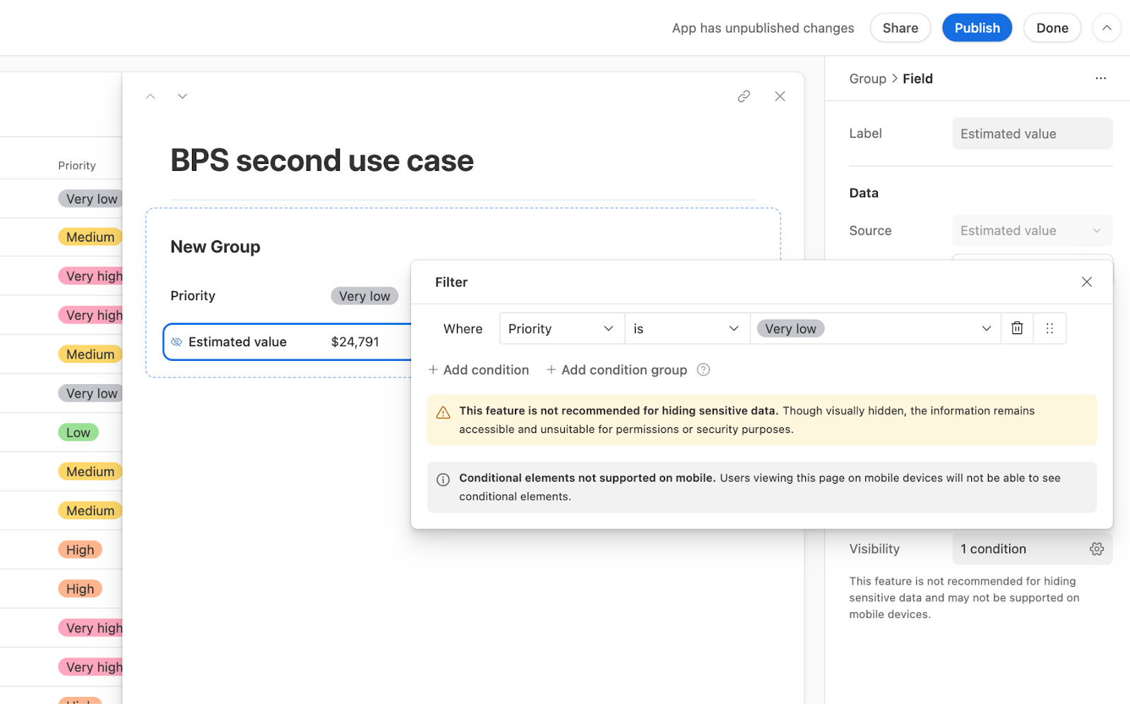

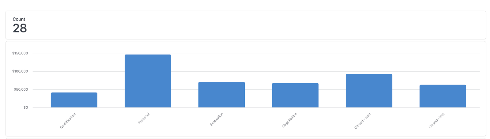

  • Field values that are used for charts are sent to a client. Consider the dashboard below that shows data for 28 deals in the pipeline. The chart shows the sum of the all the estimated value of each deal per stage. Even though you can’t tell the deal worth for each of the individual deals by looking at the chart, if you inspect the network logs, you could see the individual values for each deal.
  • Conditionally hidden field values on record detail pages can always be accessed. In the following example, “Estimated Value” is only shown when the opportunity Priority is “Very Low.” However, in the network logs, you can always see the “Estimated Value” for each record no matter what the Priority field is set to.

  • Charts and numbers will not be shown in public record detail pages.

Owners can manage interface access from the same share flow shown in the section above. The only difference here is that you will click Manage access. This will bring you to a window showing a list of collaborators and their permission levels.
From the “Manage access” menu you can:
  • Search for collaborators by name or email.
  • Filter the list of users shown by clicking the "Permission" access level and/or "Interfaces" they have access to.
  • See and change the permissions of access for users - Click the "Permission" level of an individual user or group to change it.
    • You can only change permission level access for other interface collaborators at or below your permission level. Otherwise, users with base or workspace access must be changed from those respective locations' share menus.
    • From this menu, you can remove access to an interface for your own user account only when you are an interface-only collaborator. If you are a base or workspace collaborator, you will need to adjust your permissions in those respective locations' share menus.
  • Additionally, by clicking Requests you can manage any open requests for access, which is covered in the next section below.

Configuration settings to prevent external users from seeing each other:

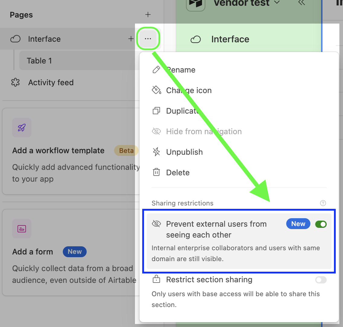

  1. Navigate to the interface where you want to apply this setting in Edit mode.
  2. In the properties panel on the left side of the page, click the … icon.
  3. Click the toggle next to the “Prevent external users from seeing each other” option so that it is turned on/green.
  4. There is no need to re-publish the interface as the changes will take immediate effect.
  5. As a builder:
    • You will still be able to see all internal and external collaborators on the interface even when this restriction is turned on.
    • You can leverage the “Preview” experience to view the interface through the eyes of an external vendor collaborator.
This setting is applied on a per-interface basis meaning that if you have multiple interfaces where internal and external collaborators have access, you will need to change this setting for each interface individually. Additionally, this setting cannot be applied on an individual interface page basis.

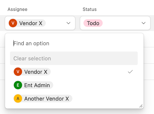

  • External users will have a redacted interface experience. They will only be able to see internal collaborators (from the enterprise in which the base was created) and external collaborators with the same email domain as themselves. Note that external users with free email domains (gmail.com, yahoo.com, etc) will not be able to see other users and are not considered to be on the “same email domain.”

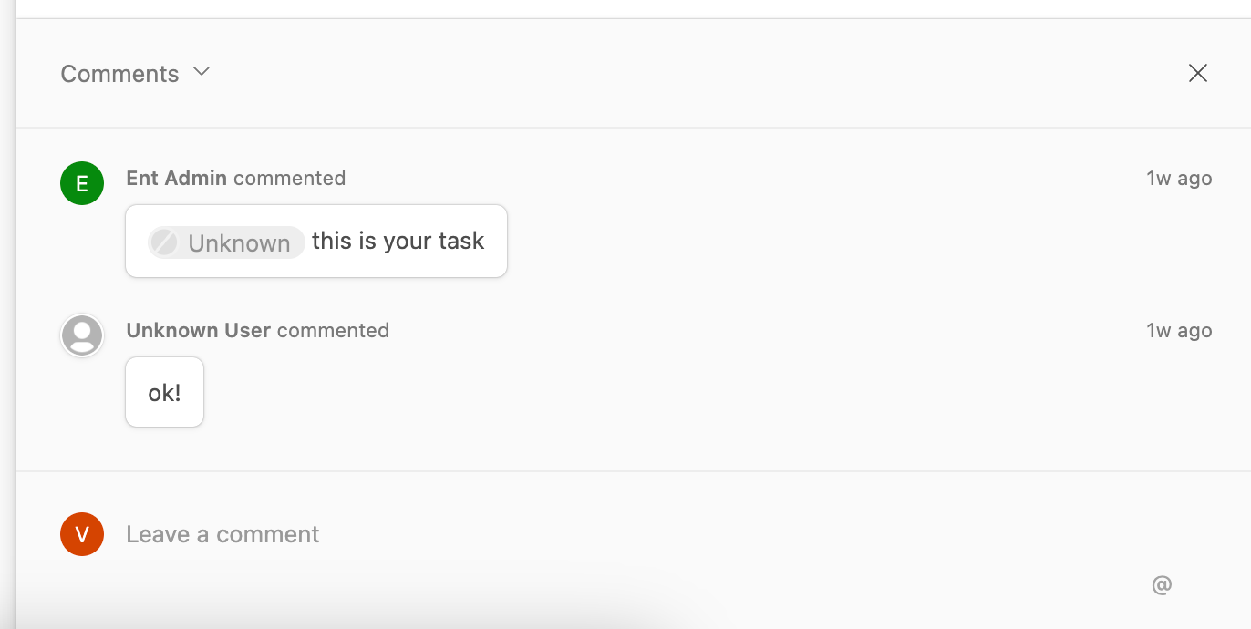

    • Collaborator list dropdowns (comment mentions, user fields, user filters) - When the visibility restriction is enabled, external users will only see internal collaborators and collaborators on their same email domain.
    • Comment authors and mentions - When the visibility restriction is on, external vendors will see all comment authors and mentions, but the collaborator tokens will be redacted (shown as “Unknown”) unless the user is an internal collaborator or on the same email domain.

To restricting interface sharing:
  1. Navigate to an interface in "edit" mode. Then click the Pages button on the left side of the page if the sidebar isn't already open.
  2. Hover over the interface that you would like to restrict.
  3. Click the ... icon.
  4. Toggle on/off the Restrict interface sharing setting.

I shared a link to an interface, but a collaborator I’m working with doesn’t have access, what might be happening?
When sharing access to an interface, always use the Share > Invite link generated from the interface's sharing settings, do not copy the URL from your browser's address bar and send that instead.
Copying the raw page URL can send recipients to a "Request access" screen even if they're logged into Airtable, because that URL doesn't carry the proper invite/access grant. To avoid this:
  1. Open the interface and click Share in the top right.
  2. Copy the generated invite link (not the browser address bar URL).
  3. Send that link to your collaborator.
If a recipient still sees "Request access" after using the correct invite link, ask them to log out and back in and then load the invite link again. If they are still unable to access the interface, check that the invite link is still active before contacting Airtable Support.
Why is interface content visible to me while editing but blank for other users/viewers on a published interface page?
If an element of an interface page displays correctly while you're editing an interface but appears blank or missing for viewers of the interface, check the following:
  1. Confirm the page has actually been published, since edits made after the last publish won't appear to viewers until you republish. Click Publish in the top right of the interface.
  2. If you duplicated an interface or page, confirm the duplicate itself has been published; duplicates start as unpublished drafts even if the original was live.
  3. Check that the interface page’s content isn't conditionally hidden based on permissions or view filters that exclude the viewer's role.
