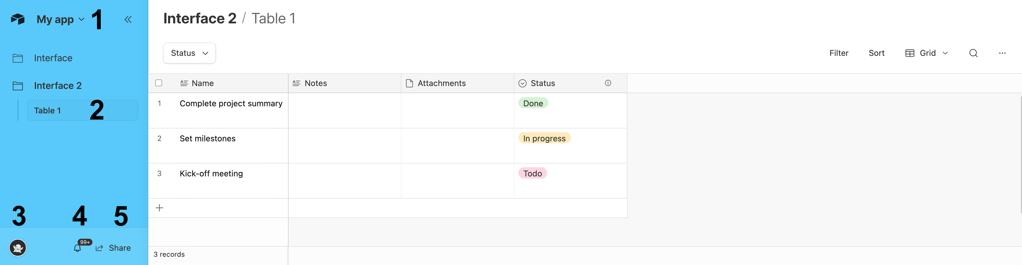

Step 1: Add an interface
  1. There are three potential entry points where builders can add a new interface:
    1. From within a base (AI-enabled workspaces) - Ask Omni to build you an interface customized to your particular needs in order to hit the ground running. Find more information about Omni here.
    2. From within a base (Manual) - Inside a base where you would like to build a base click the Interfaces option in the upper portion of the screen.
      1. If this is the first interface in the app, then you'll be brought to a screen where you can click Start building. Then, click the Build an interface option. To learn more about building forms, see this support article. Name the interface and choose an icon (this can be edited later). Then, click Next.
      2. Otherwise, you'll be brought to the interface editor where you will see previously created interface pages. From here, click the dropdown icon at the top left next to the name of the base and select the Edit option (Option 1 shortcut). Then jump down to the " Editing previously configured interfaces" section below.
    3. From the home screen - This option is covered in a separate support article that you can find here.

Navigating published interfaces
When accessing a published interface, there's a navigation menu on the left side of the screen. Certain options will only appear for users with the appropriate permissions, such as the ability to edit the interface, but in general, most users will have a similar experience to the one discussed below.
  1. Interface dropdown menu - From here you can:
    1. View data - Navigate to the underlying Airtable base, so long as you have base access
    2. Edit - Access interface builder if you have owner/creator permissions in the base. Editing previously configured interfaces is covered more extensively in the section below.
    3. - Back to home - Navigate back to your account's home screen.
  2. Interface and interface page navigation - Clickable navigation to access the various interface groups and pages of the app. Some interfaces or interface pages may not appear if:
    1. They have not yet been published.
    2. Certain pages were hidden from the navigation by the interface builder.
    3. Only one interface has been published. Once another interface has been published, both interfaces will appear in the navigation.
    4. The destination is a nested record page more than 3 levels deep and the user is an interface-only collaborator. Interface-only collaborators can open a maximum of 3 levels of nested record pages, so a deeper path doesn't open for them even though it works for base collaborators. To learn more, see this section of the interface permissions article.
  3. User account menu - Learn more about the Airtable home screen
  4. Notifications - Learn more about Airtable notifications here
  5. Interface share menu - Learn more about sharing interfaces here

Why don’t I see the navigation sidebar on my interface?
If the published interface only contains a single interface/interface page, or if you are a user who only has access to a single interface page, then the navigation sidebar will not appear since you cannot navigate to another page.
If your interface should show multiple pages (and, hence, the navigation sidebar) then double check that the interface is published and that the appropriate interfaces have been shared with end users.
